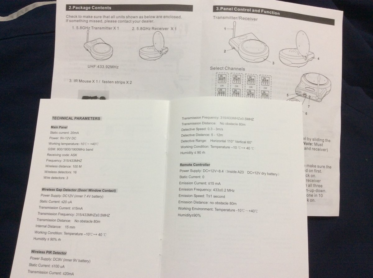

Now some sensors and sometimes the external siren are not responding and he believes it's to do with my video sender made by Nikkai 5.8ghz I have 1 sender 3 receivers.
Anyway I never believed that but looking at manual (pls see pic) it seems he may have a point as I can see 433mhz on both manuals.
I'm no whizz so that means nothing to me but if that is cause of interference and is stopping SOME (not all) sensors from working and also making my external siren intermittent
Does anybody have any advice ??
When I switch the digi senders off they mostly work - except the siren don't know if permanently messed up now as that doesnt ring at all. defo not mains issue btw.
Will all video senders be the same?
Can I change the 433mhz it uses?
so annoying as im quite reliant on the receivers but obviously want my sensors/siren going off.
image-jpg.85399
jim345
Established Member
I assume the 433MHz is used by the Receivers' return channel (for IR remote commands). I doubt the frequency is changeable like the 5.8GHz channel, but the manual would tell you. Switch off the receivers and check if the alarm is still affected.
433MHz is used by a lot of equipment, including doorbells and key fobs, though usually they only transmit briefly.

Can somebody please explain to me for my peace of mind what IR operating frequency: refers too?
I thought IR was to do with remote controlling from another room - or is it associated with the A/V part of the videosender?
Nikkai 5.8GHz Phono Video Sender Kit | Maplin
"IR operating frequency: 433.92 MHz "
As mentioned i was getting interference and its stopped my siren working. but atleast sensors are all good so i get my texts and internal siren works too.
but i wondered if it was the remote control part of the device that functions on 433.92 MHz (AS DOES THE HOME ALARM) - then if i could just take that lead out.....but still use the sender for A/V purposes???
