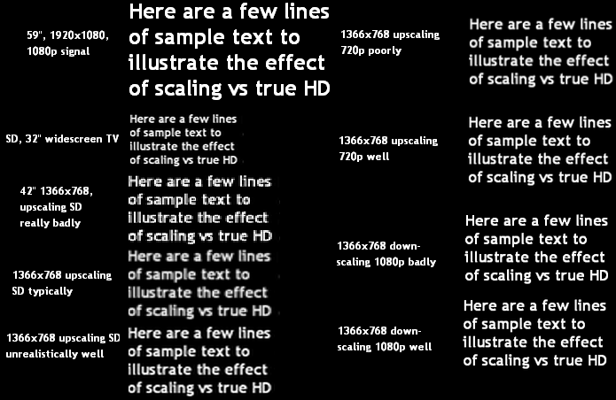

Please excuse my thickness as i am struggling to get my head around everything. I am looking to get a new LCD, the Samsung LE37R41B, i will be sat approx 10 feet from the screen. i am unlikely to be getting HD for a while as i think it'll be too expensive to begin with so will just be watching normal sky and dvds. i really want a bigger tv than the 32" i have at the moment, will the 37 be too big and therefore not look very good quality? Should i be looking at the 32" version?
That screen is 1366x768. For a viewing distance of 10 feet, a screen with that resolution has an optimum screen size of 55 inches. So 37 inches is far too small. :)
That, of course, presupposes that you're viewing a hi-definition signal. With upscaled SD it becomes a bit more complicated.
I've attached a PNG which gives you an idea of the effect of upscaling on a picture: you need to view it with your face quite close to the monitor screen - almost close enough to make out the pixels round the edges in the fourth line of text. And you need to view it FULL SIZE, not just look at the "attached thumbnail"!!!
Imagine that the top line of text is an SD picture. If you make the screen twice as big with no scaling, it looks the second bit of text. If you make the screen twice as big with very very good scaling (better than you will ever actually get in the real world!) it will look like the third line of text. Genuine hi-definition might look a bit like the fourth line. (Probably a little better).
Clearly, line 4 looks better than any of the others, and line 3 looks better than line 2. But does line 3 look better than line 1? Even if you assume scaling is that good, by how much could you scale up line 1 before the effect becomes annoyingly blurry? Hard to say.
All this talk of HD and scaling inspired me to do some slightly more realistic examples. I've done another PNG file which illustrates the differences between various amounts (and qualities) of scaling. But the stupid AVForums script refuses to let me attach it, because it's 700 pixels wide :rolleyes: so you'll have to launch it in a separate window.
CLICK HERE.
We begin with part of a notional 1920x1080 signal, displayed as it would be on a 1080p screen of approximately 59" diagonal. You can then compare how the same image might look downscaled to an anamorphic PAL TV picture and displayed on a widescreen TV of approximately 32" diagonal; how the same DVD image would look on a 42", 1366x768 LCD TV upscaling badly, typically, and unrealistically well; and how the same LCD screen might look upscaling a 720p high definition signal, or downscaling a 1080p hi-def signal.
Again, you need to view the image full size, and have your face really quite close to the screen - almost close enough to see the pixels in the largest sample text.
