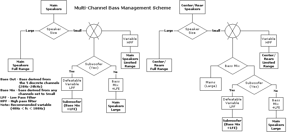

    Well here's another bit of confirmation if you're still unsure... THIS diagram shows that regardless of whether your fronts are set to LARGE or SMALL, they are automatically treated as LARGE if you have "NO SUB". Then, the bass mix of the SMALL speakers (a mixture of all the frequencies below the SP low-cut for all the speakers set to SMALL), AND the LFE channel (LFE frequencies BELOW the LFE High Cut), is sent to your fronts.
    So make sure LFE High Cut in your amp is set to 120Hz, and set the SP low-cut to as low as your SMALL speakers will go. If you have it set too high, you will get directional audio information that was supposed to be sent to the right rear for example, sent to the fronts. That's no good.
