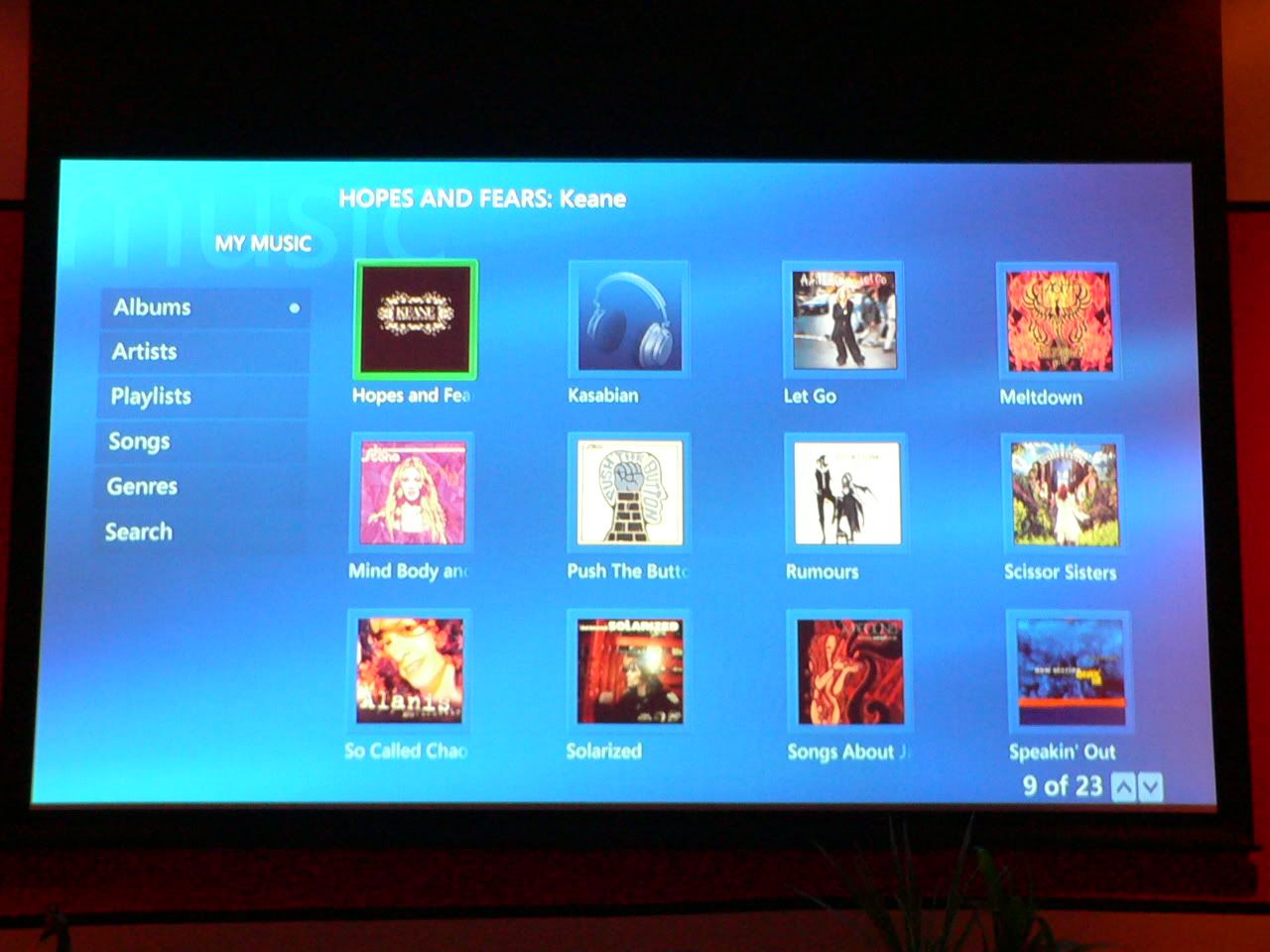

    http://img.photobucket.com/albums/v136/zAndy1/HTPC Pics/P1000003.jpg - highlighted the My Music option and it shows thumbnails of the cover art the most recently played albums
    http://img.photobucket.com/albums/v136/zAndy1/HTPC Pics/P1000004.jpg - now in the My Music option, as you can see it shows cover art for all albums it finds, all my music is stored on my PC upstairs (the one I'm using now) and MCE finds it and plays it back over the wireless network with no dropouts whatsoever

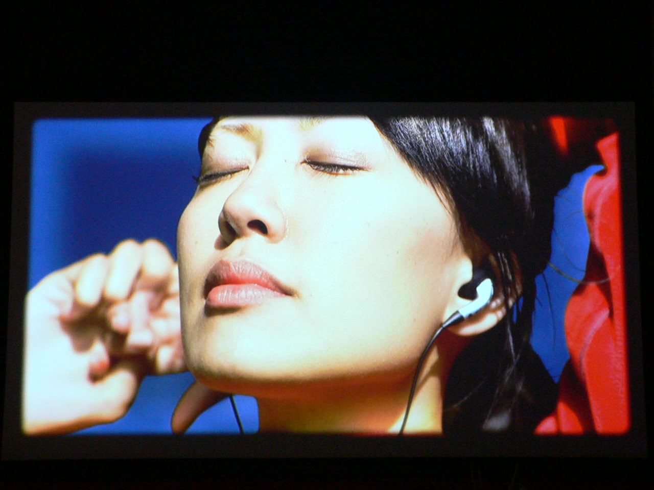

    http://img.photobucket.com/albums/v136/zAndy1/HTPC Pics/P1000011.jpg - a WMVHD demo clip hidef, trust me it looks a lot better than this in real life!
