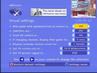

had a look on the STB options and I couldnt find anything to set it to RGB output???? saw the setting to 16:9 though cause it was set to 4:3 much better but still unhappy with the PQ.

If you look at the following screenshot, the bottom option (under 16:9, 4:3 option) is the one that sets either composite or RGB output. I'm afraid there is no other way of extracting audio out from the newer NTL STB's other than using a SCART cable with audio breakout
*EDIT* I just re-read your original post and a fully wired SCART cable should feed stereo sound to your Viera too, it shouldn't just be audio only. The only reason for needing a SCART with audio breakout is if you want to feed a separate 5.1 surround sound amp. I would check that your SCART is not damaged in anyway or has a full set of 21 pins in the SCART plug.

i have NTL too but mine looks different. I cant even access settings. The settings button on remote doesn't bring up anything? How can i check if i can use an RGB scart or just a normal scart to scart lead. Will i have to call NTL up?

try guide then look across the top for settings then try that (asuming ntl digital)

oh boy, you're a star. Got it working on 16:9 and RGB. So, if i now buy a scart scart RGB cable and connect it from NTL to plasma, it should be even better? WIll i not be able to get any sound then as the problem in first post?
