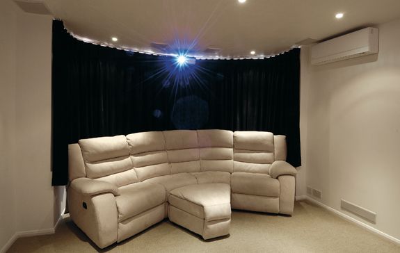

Taken with my tab so pretty crap but here you go.
And the results
The missus keeps her front room and I get as close to bat cave as I will ever be allowed lol. She even likes the ceiling as the veneer breaks it up and makes it a feature.

Very nice sheep you have made a decent job of it mate.

Thanks mate, They were only £19.99 curtains but work really well lol. Just need to get my grey screen and a calibration and I will be happy.......for a while lol

I've got my dedicated room set up now and I'm very happy with the results I've got, I have a black out blind over the window and complete blackout curtains as well.
I have black rugs from ikea over the floor and it sounds and looks brilliant.
However I havent yet gone down the route of addressing the ceilings and walls as my new landlord nearly had a fit when I mentioned painting the ceiling black
So now I'm thinking that I will get some devore fabric and use drawing pins to attach it to the ceilings and side walls and leave the rest of the room as it is.
Would this work?
I'm looking to have as little impact in terms of lasting damage to the room as possible to avoid making my landlord have a heart attack
Forgot to mention I have some plain black fabric that I could use for either the ceiling above the screen or down the side walls.

Hi Ginger
I have got some devore to put up on ceiling and I did think same as you, just put up with drawing pins. I've decided to make a lightweight wooden frame and stretch the material over that (and screw it up on ceiling) because I think it would be really hard (unless you are really, really patient) to get nice straight lines) using the pins. I have used drawing pins where I've put devore over the inside of a white door adjacent to the screen. It's functional, i.e. the door reflected massively back onto the rh side of screen before, but now it just looks black, and doesn't wash out the image on that side of the screen.....but it looks a bit of a bodge job when you look at the door (from seating position 3m away I obivously don't notice it, so acn live with it, but if it was similar on ceiling, and maybe in my eye-line it would bug me).
