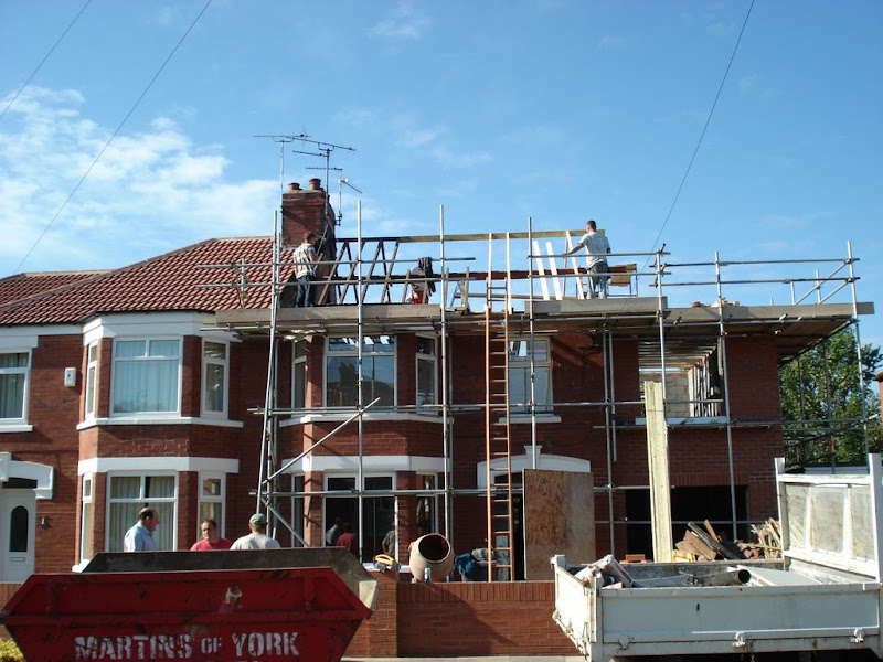

Hi all, I've been reading this forum for quite a while now and have really enjoyed reading everyones threads and watching each home cinema from start to finish, and I thought it was about time I shared my progress with you so far and contribute to the site.
We are currently 4 months into a total overhall of our house, practically everything in the building is being renewed and has been gutted right down to the brickwork. We have actually moved into the house next door which was renovated last year, once we finish work in our house then next door will be sold on.

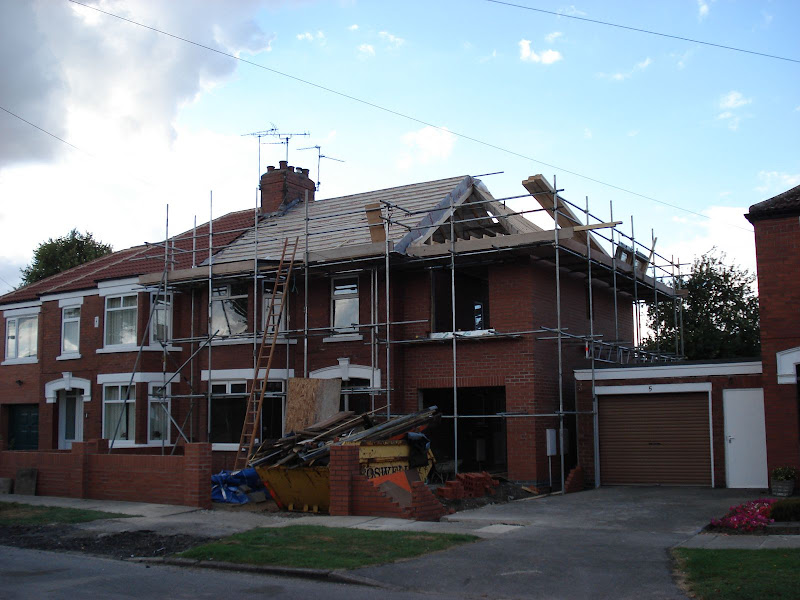

Firstly the existing detached garage was knocked down in July, then work began on a new attached garage with a kitchen extension to the rear, and new bedrooms with en-suite above the garage. In August the roof was almost totally removed and rebuilt across the bedrooms extension, and a staircase built up into the loft, which is where the home cinema will be!
Kit bought so far: Panasonic AX100E projector, Onkyo 605 receiver, KEF 2005.2 5.1 surround speakers, and a hell of a lot of QED SA XT cables! These are all currently sat in the wardrobe waiting to be let loose.

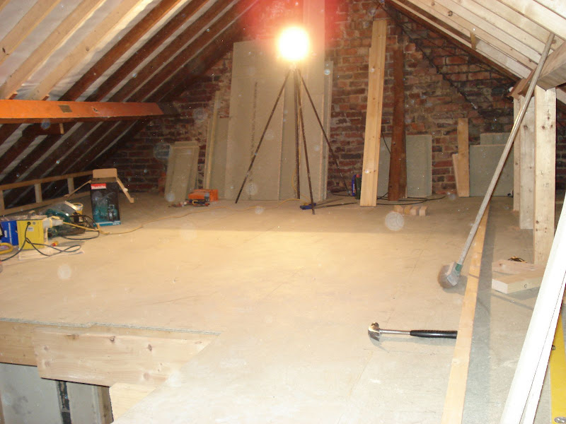

The room taken from the top of the ladders once all the furniture was taken out (please excuse the orange walls!)

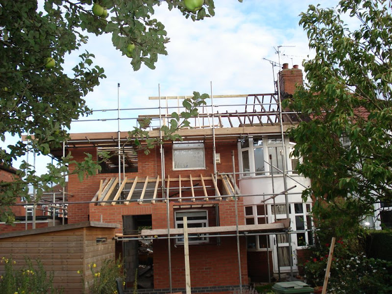

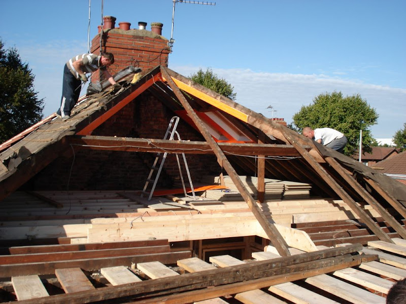

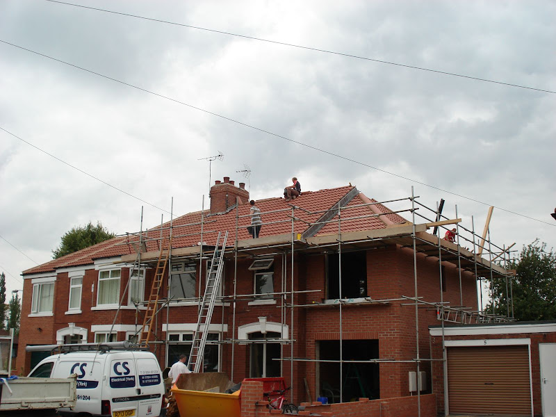

The roof on its way down:

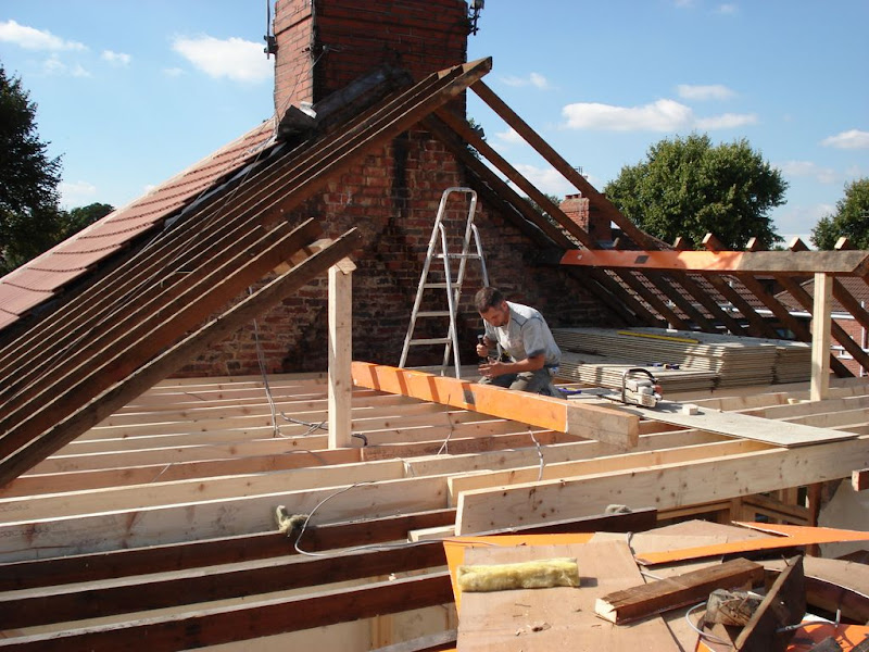

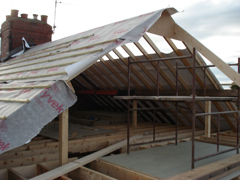

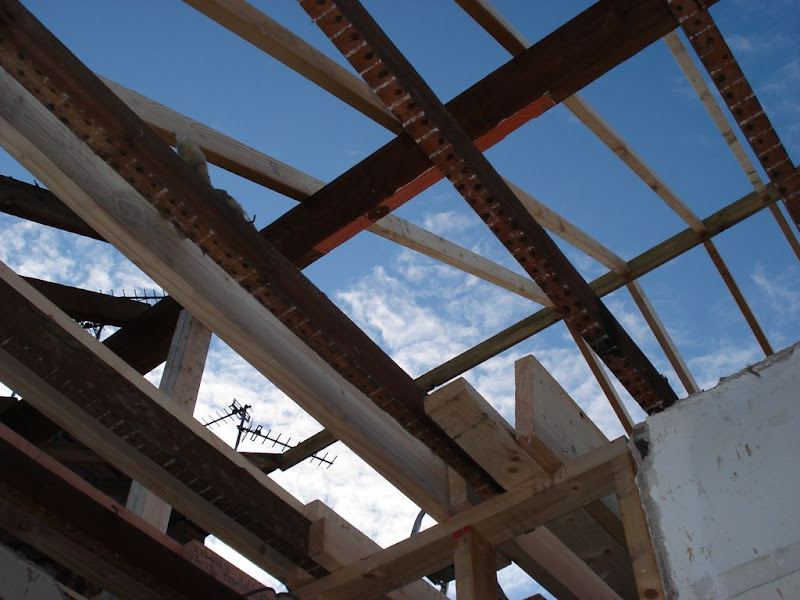

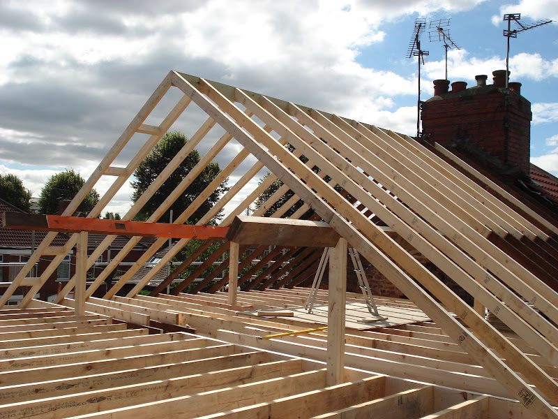

New roof going up:

New roof being built:

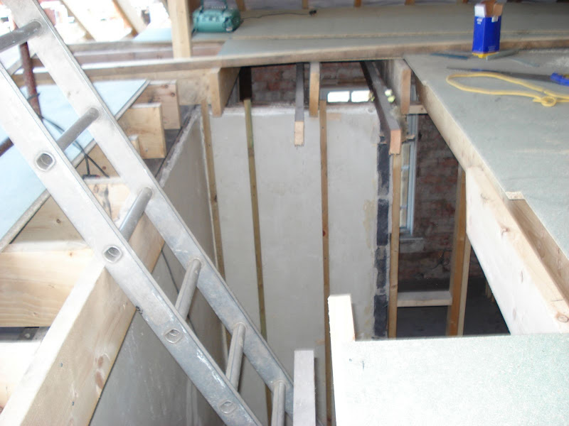

Hole for the stairs:

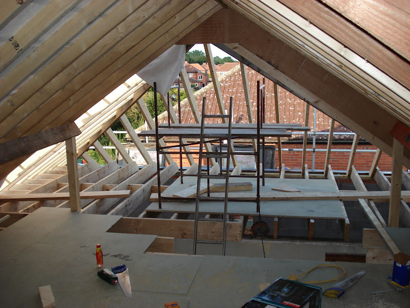

Completed roof:
Floor down:

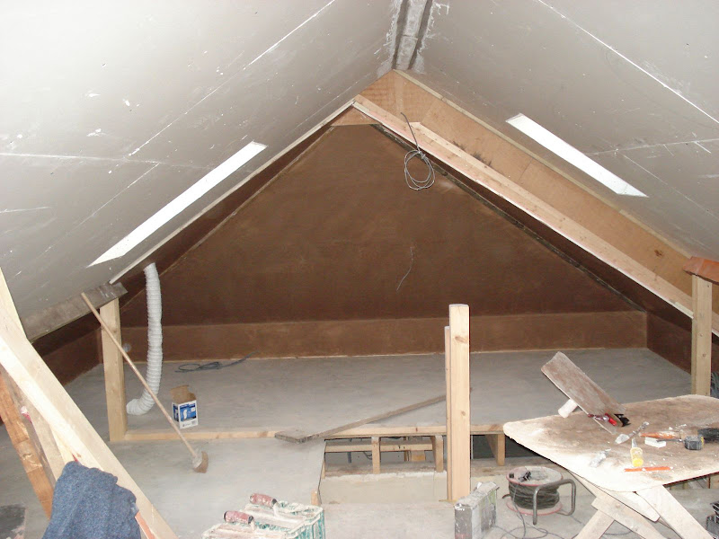

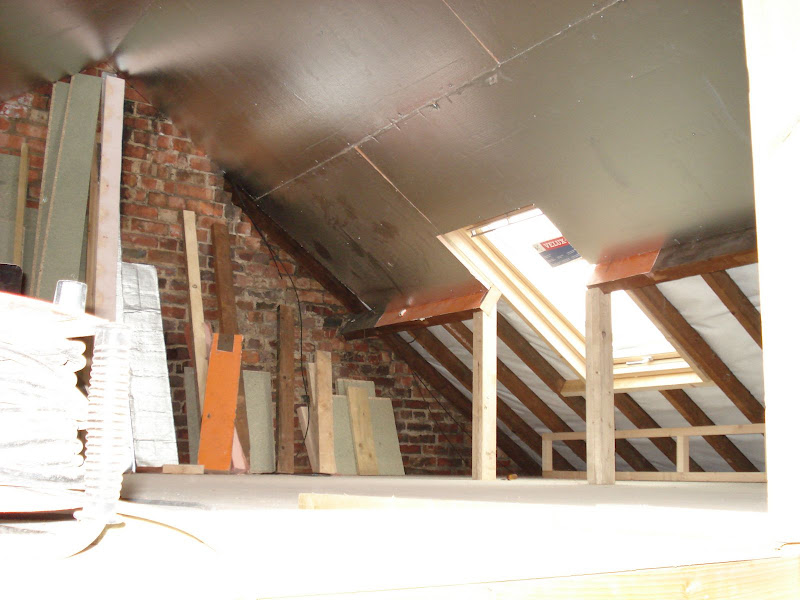

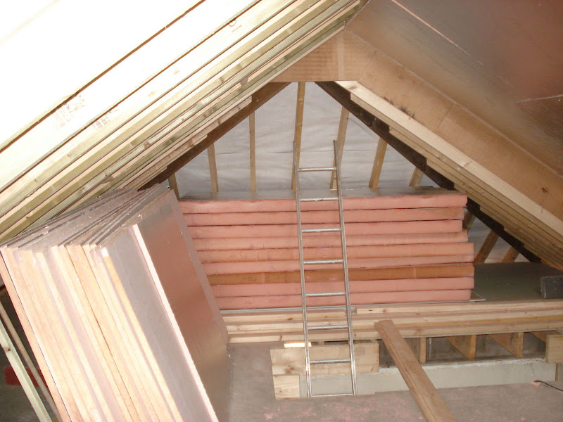

Masses of insulation:

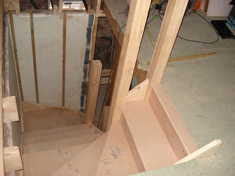

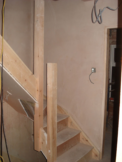

Staircase built:

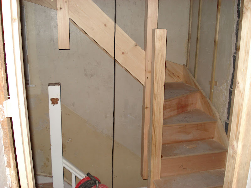

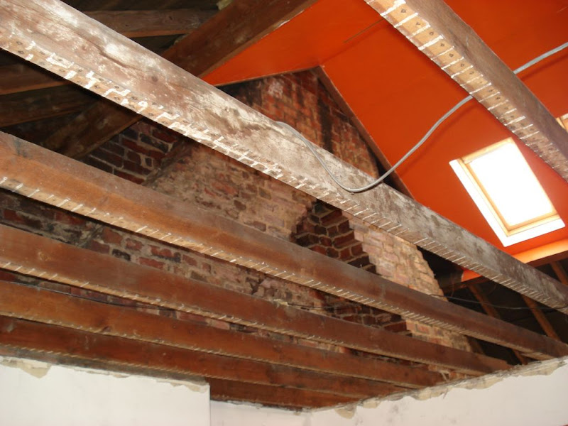

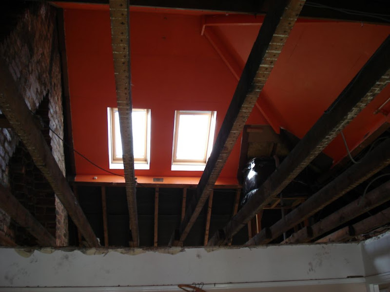

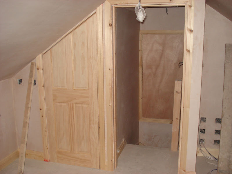

Was the step down in the roofline a planning requirement and what was the purpose of pic 332, did you lose something down there?
Can't wait to see the 2nd fix.
Andy Brown
Yes the step back is a planning requirement, they dont seem to allow an extension to the side of the house to be right to the front, I think its so that it doesnt create a terracing effect to the style of the house, and thus the roofline had to follow above. Regarding pic 332, it was a photo of between the two rows of brickwork from where the knockthrough is leading to the two bedrooms above the garage, I think I was trying to be arty with the shot!

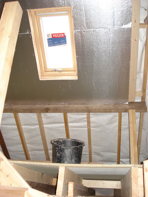

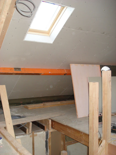

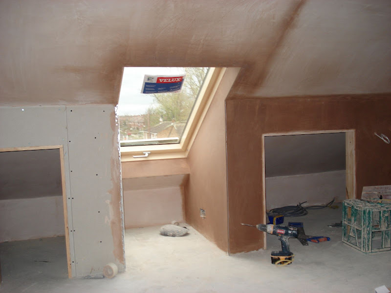

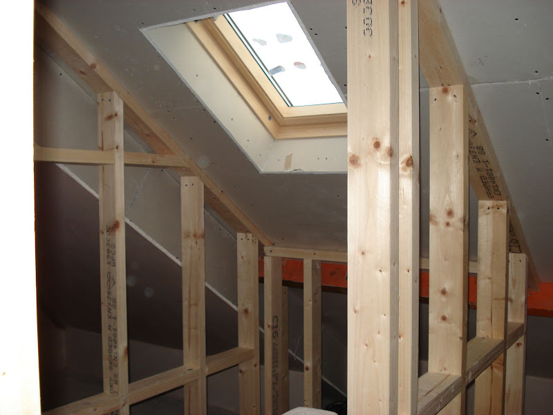

Large Velux in:
Velux in toilet room:

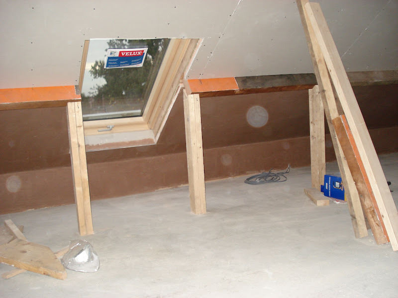

Velux above stairs:

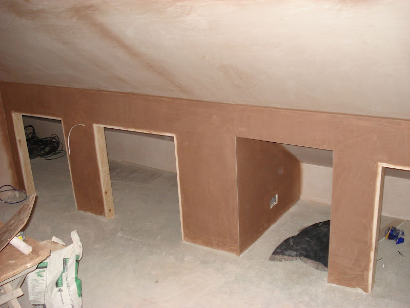

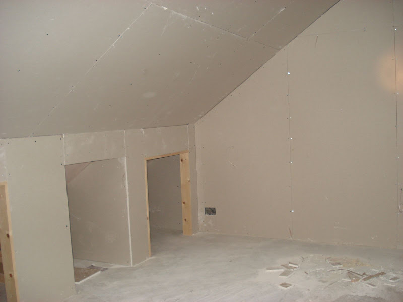

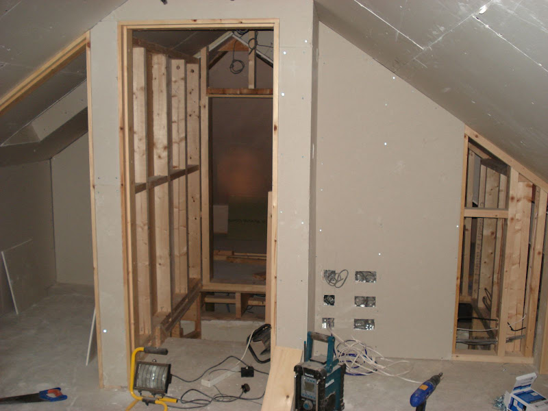

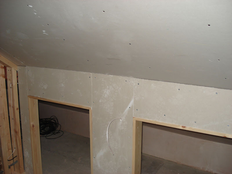

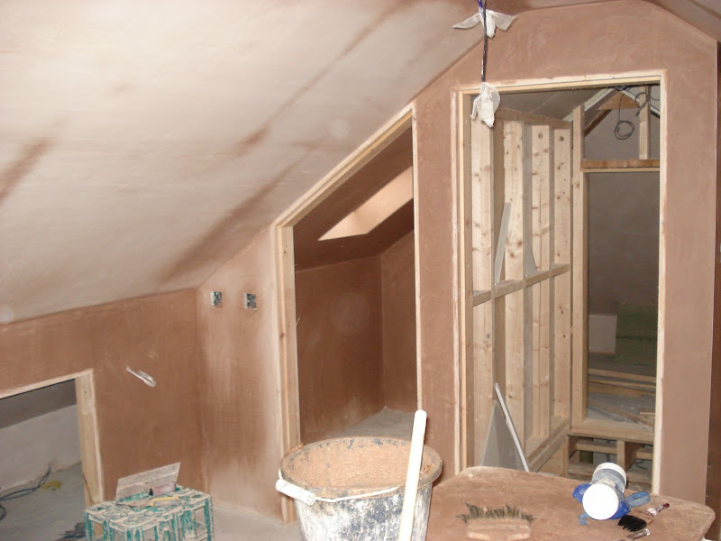

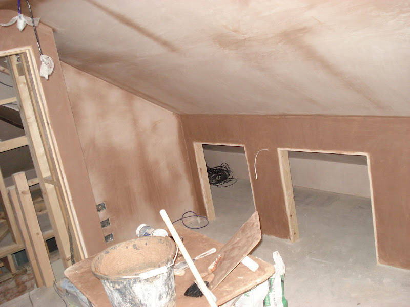

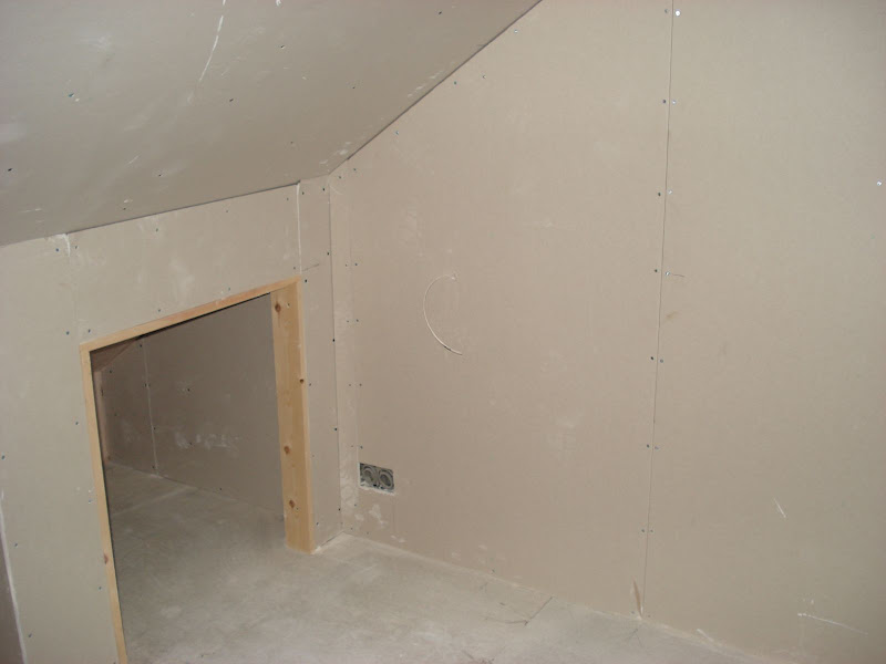

Plaster boarded out:

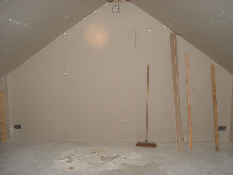

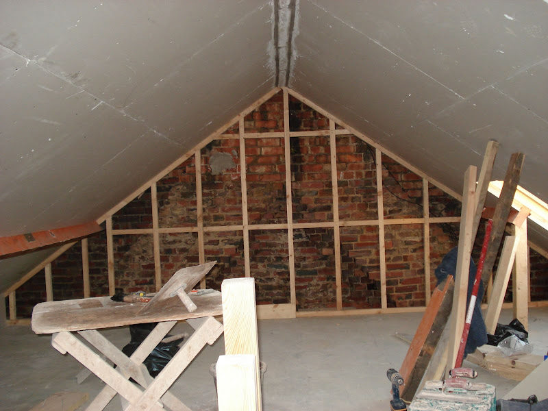

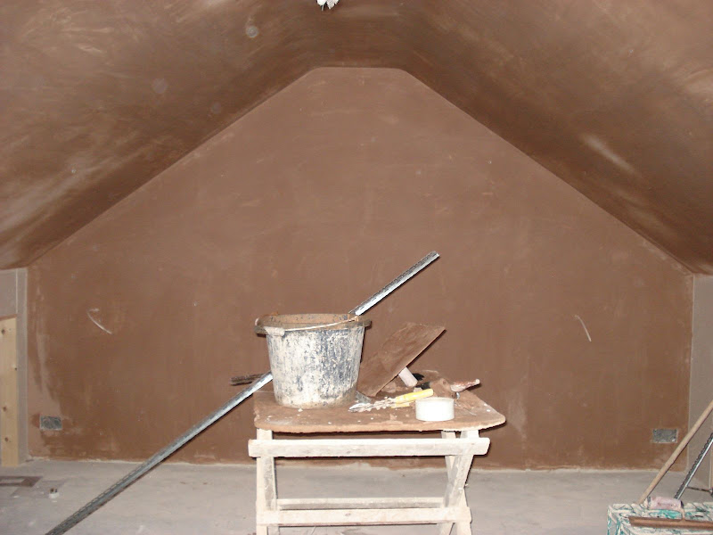

Screen wall:

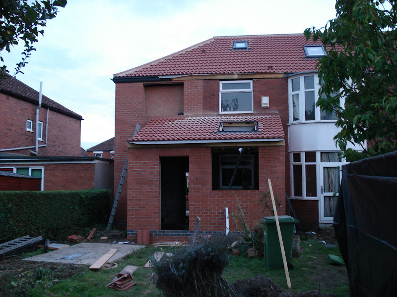

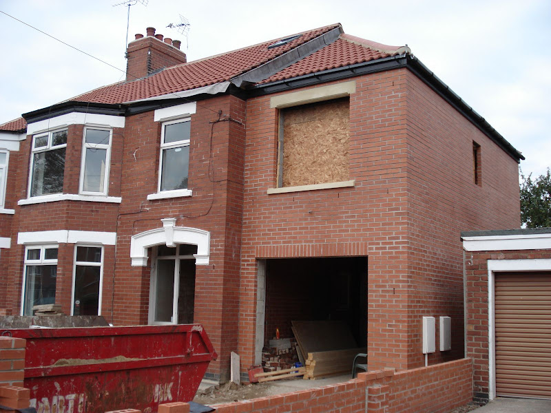

Rear of the house:
Front:

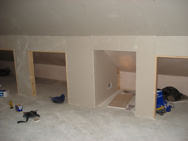

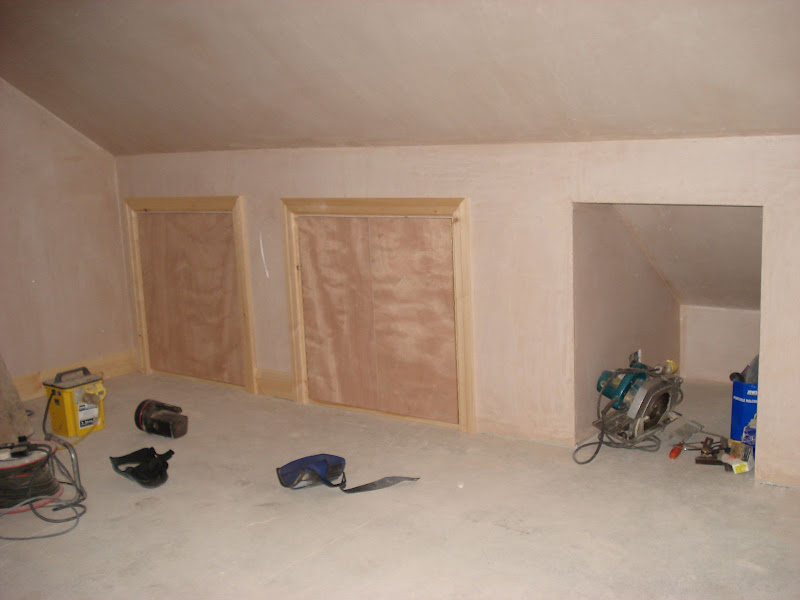

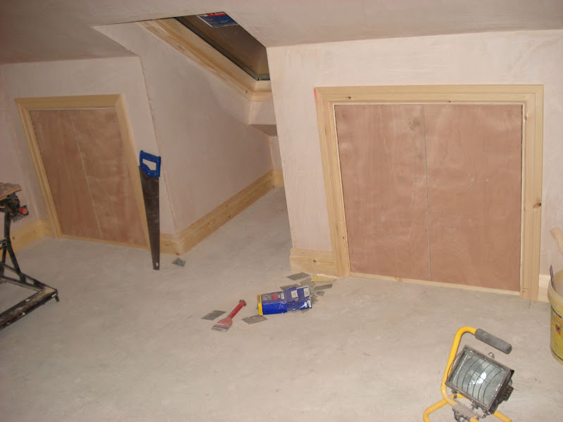

Initial plastering around cupboard areas:
Storage area to the back:

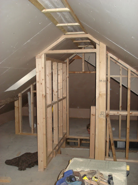

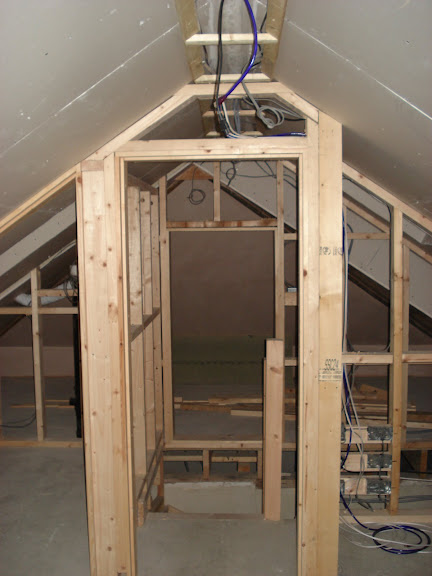

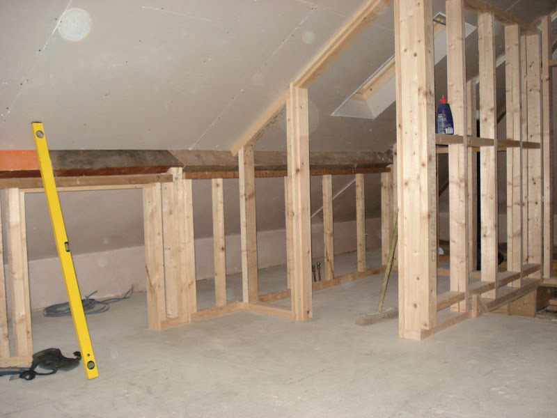

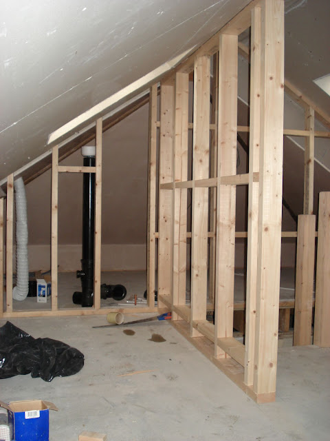

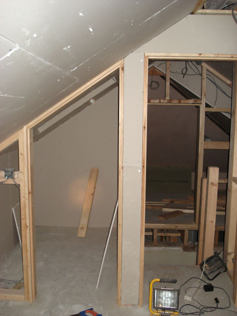

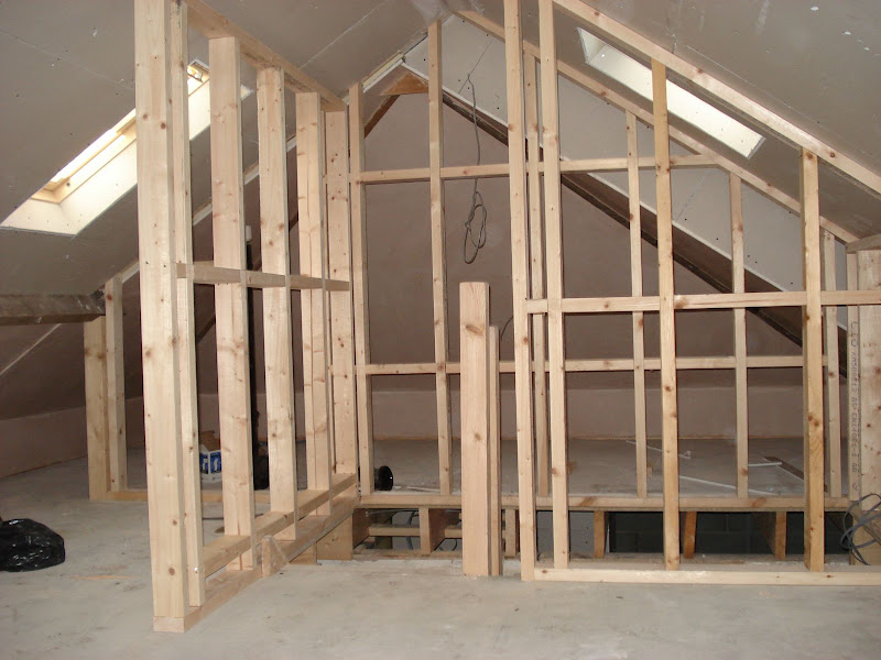

Timber stud work up to separate cinema room, toilet and stairs:
Door frame to toilet room:

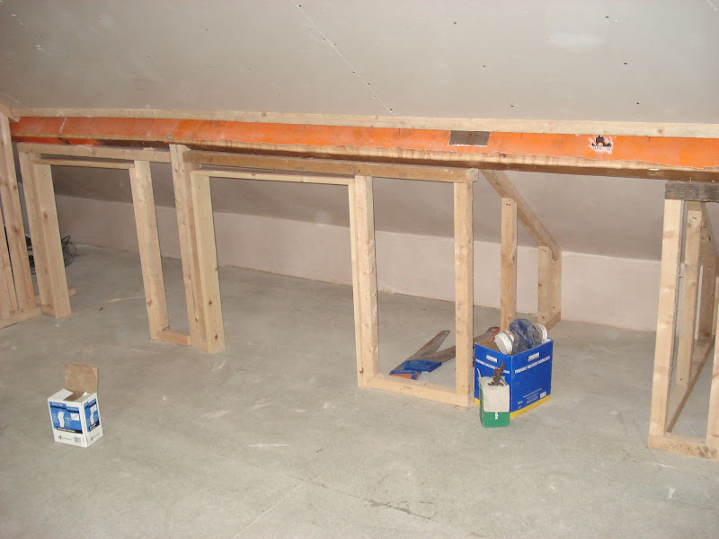

Cupboard frames and gap for fridge:

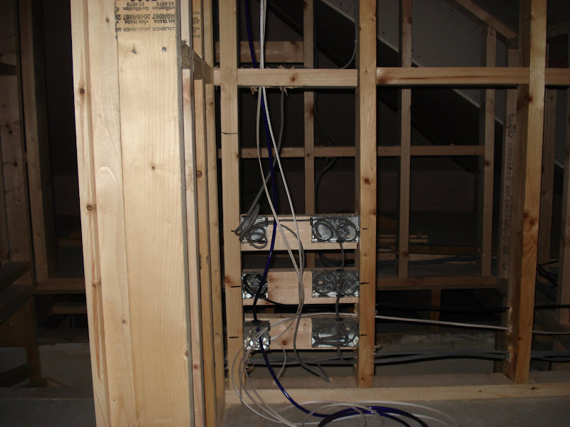

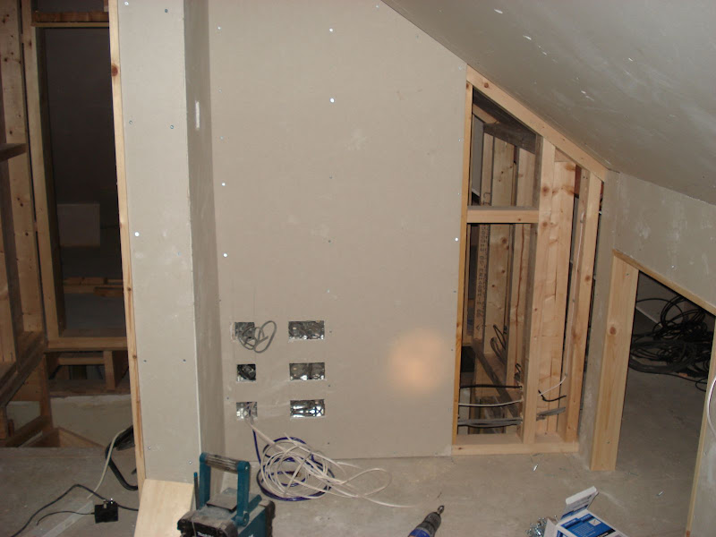

Few new pics of the wiring so far last week:

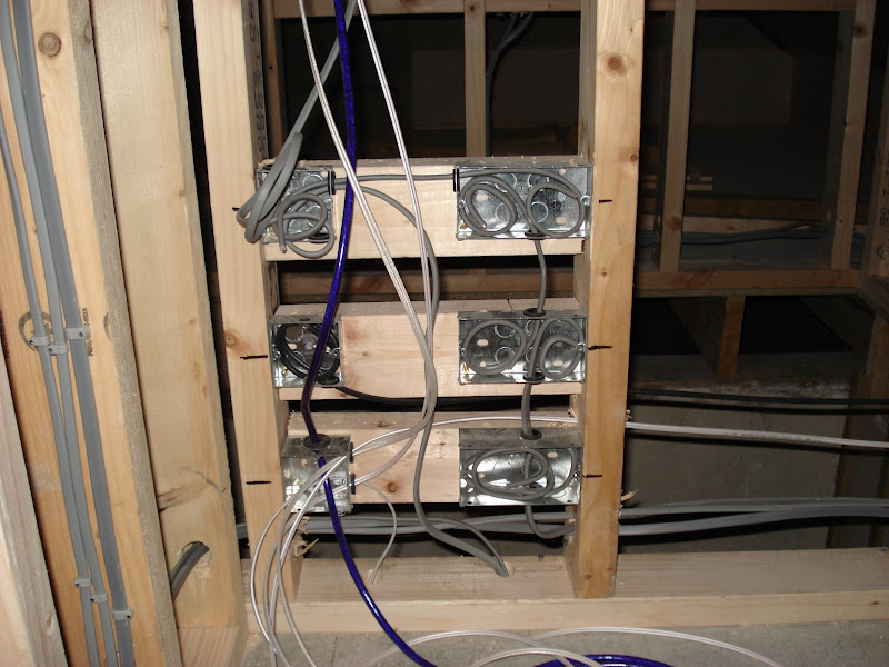

Boxes for 3 double gang power points on the right, and the singles are for a fused spur for the projector, a TV aerial socket, and the lower left box is where the HDMI to the PJ and 5 speaker cables will exit.
The sparky certainly isnt the tidiest around!:

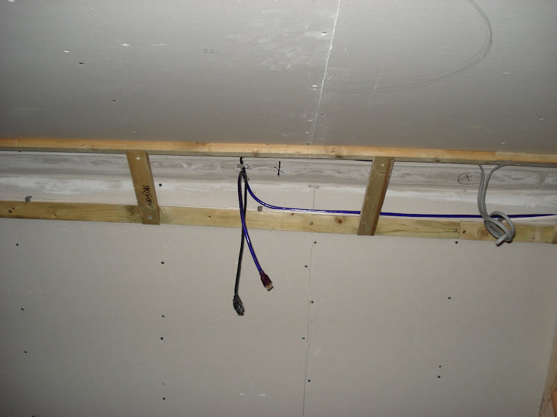

Power and HDMI cable to the projector:
View to the back of the room showing the cable routes:

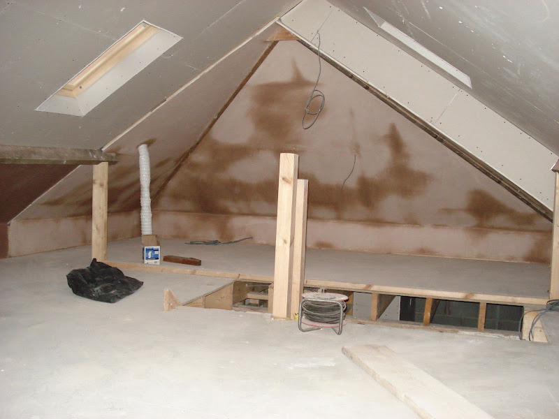

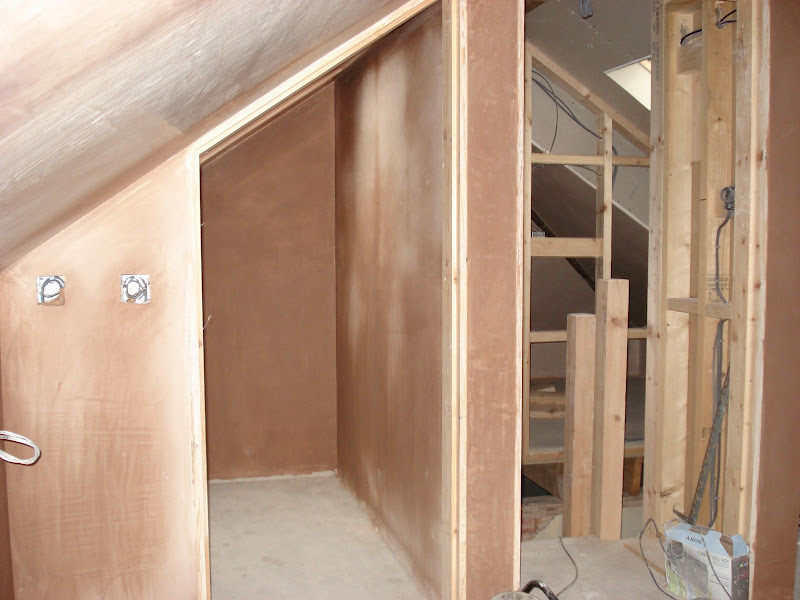

Update from today:

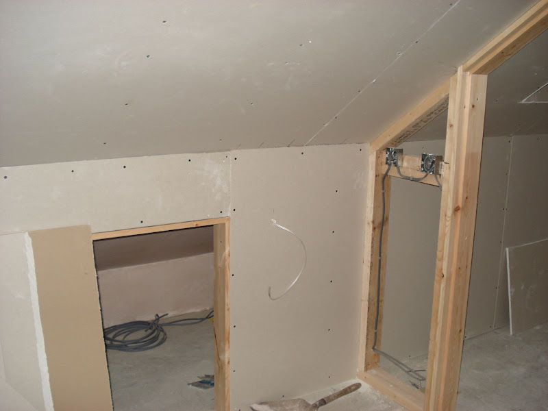

Most of the room has been plasterboarded now:

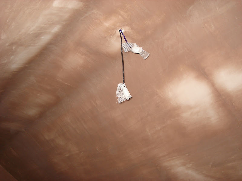

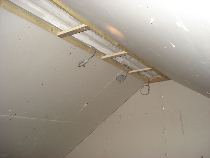

Spot light power cable:
Front left speaker cable:
Rears:
Not far off being able to get the plasterer in to finish the job off now, then theres just the rest of the house to plaster!

As mentioned above, can you spot the cabling mistake?:
QED HDMI and power cable for projector:
Door into tiny toilet to the left:
Anyone over 5.5 foot has to duck!:
Plenty of cupboard space:
Fridge space here:
Feel free to browse the rest of the images of the whole of the building work here: http://picasaweb.google.com/cjmilner999/BuildingWork

Hi Chris
its no prob to do the cable, in fact rather now than later I think you`ll agree. Its coming on a treat mate and I like all the storage space you`re creating.
Also I think you`ll be ok with the loo as I`ve never seen a duck taller than 5 foot

Managed to sort the cable problem I think, just been in there cutting a groove in the plaster using a stanley knife and routed the cable 200mm to the right, and left an appolgy note to the plasterer for the mess!

Been a while since I posted some photos, the loft is done as far as can be really until the painting and carpets are fitted, though this will be a fair while away as the whole house will be done together.
The plasterer is working his way through the house from top to bottom so so far the loft, 2 new bedrooms, bathroom, and 3 old bedrooms are now done.
The main work that is still underway is the new stonework at the front of the house which the brickies are almost done fitting. This involved the whole of the bay window from top to bottom being pulled down brick by brick and being rebuilt with new clean stonework and steel framing behind for added strength.
See the whole Picasa web album for photos of the rest of the building work (link in sig)

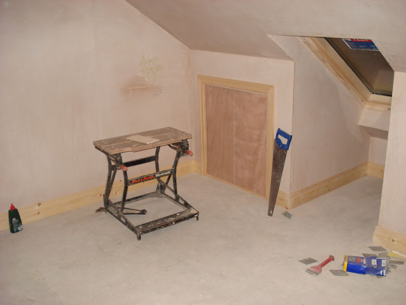

Cupboards fitted with doors and frames in cinema:
Plastering down staircase:
Chris
