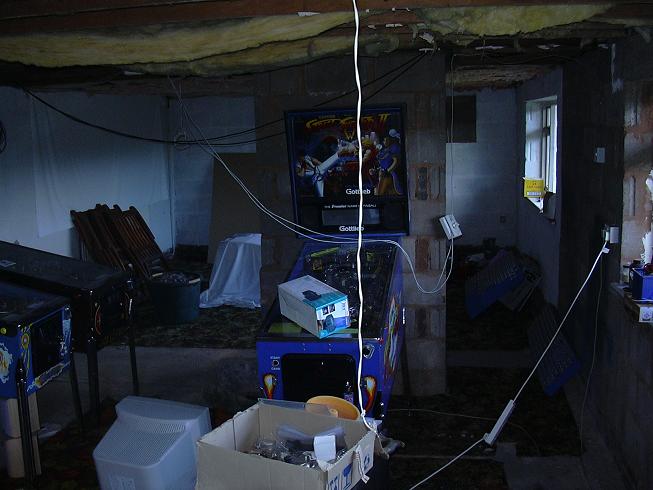

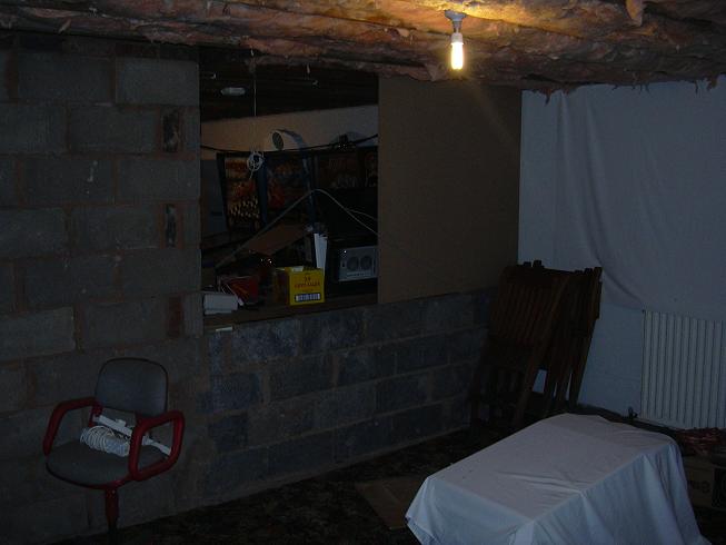

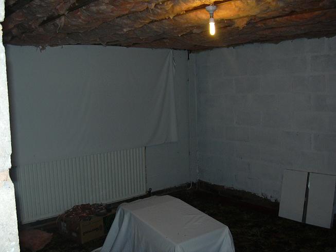

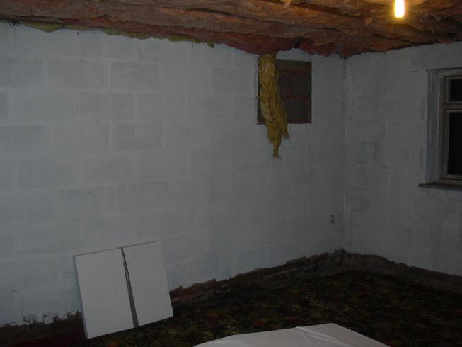

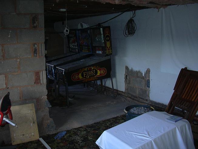

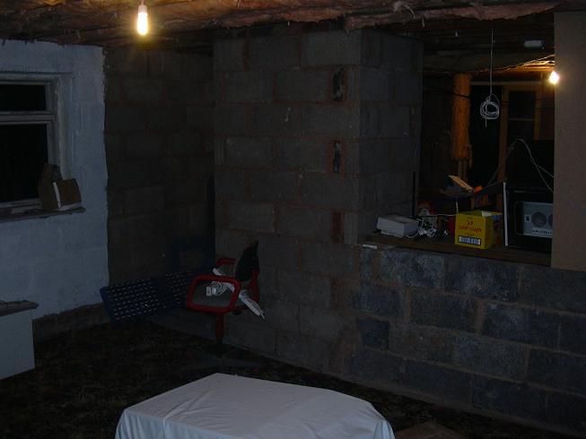

Heres some pics of the space right now:
Front left:
Front right:
Back left:
Back right:

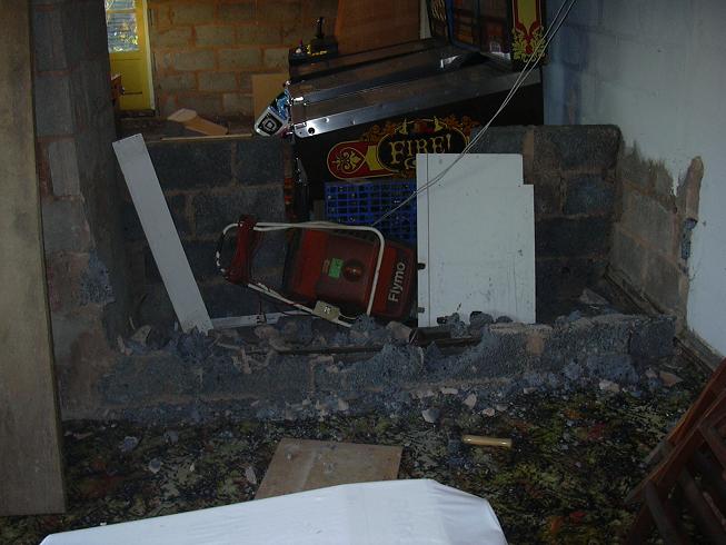

Got my hammer out today, this marks the official start of work!:
The previous owner of the house has left me a little present - anyone want a Flymo? LOL
I think I've pretty much decided that the best way to go is completely insulate and board the entire ceiling as one lot before starting the stud walls etc, so I can get a good airtight seal around the perimeter. So that means I need to run the 2 new ring-mains, network cabling, projector cabling, lighting etc first...Careful planning will be needed!

OK progress is slow, as expected. Finished removing the old block wall:
Here's a view from the back, this bit will be the games room.

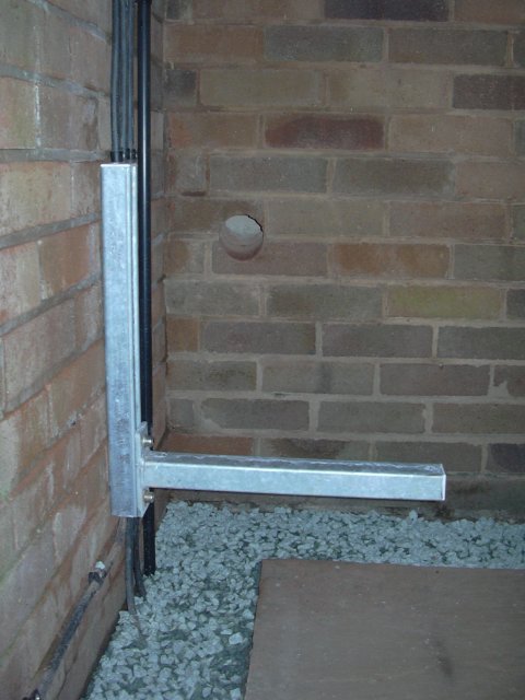

The outside part of the air-con unit has been bolted onto it's brackets as in this pic:
Havn't drilled a big hole in the wall yet for the pipes, or mounted the internal units. Need to build the internal partition wall first!

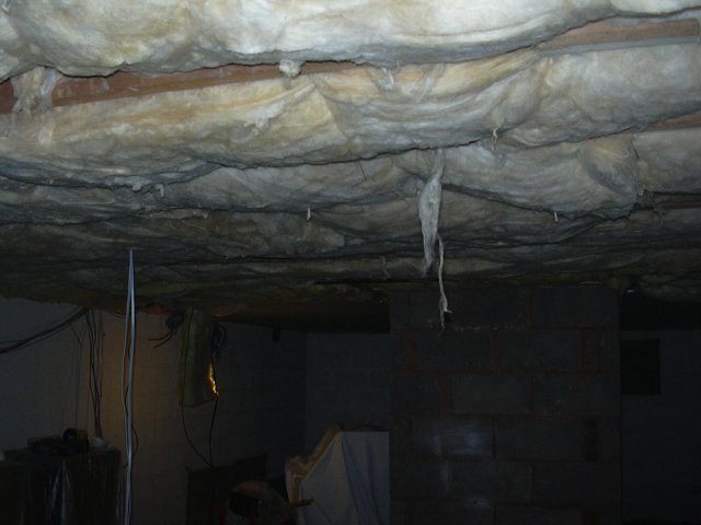

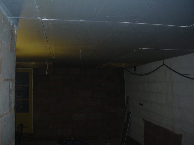

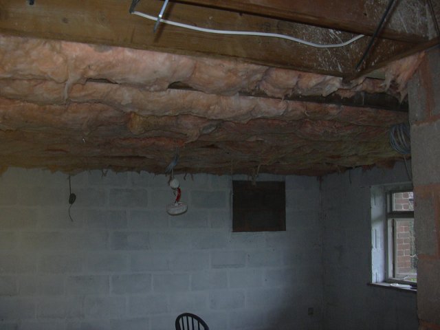

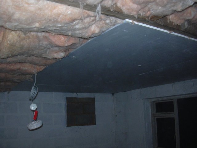

Well I want as soundproofed as I can get, without getting clever with resilient channel and all that stuff. Got my mate round today to start putting the boards up, we stuffed a load more insulation between the joists - as I understand it you would normally leave it a bit 'fluffed up' for normal heat retention purposes, but need to jam as much in as possible for maximum sound proofing!
Heres a pic with the insulation up there:
Those boards are seriously heavy, we used a couple of props to make sure they didn't fall on us whilst putting the screws in, but still very awkward!
Well we've done nearly half of the first layer of the cinema room part - so that's about 1/8 of the complete ceiling!!
Would you recommend filling the gaps between the boards on the first layer with jointing compound or whatever it's called? I plan to seal around the edges with a flexible acrylic sealant before fitting the second layer too.

OK, now the ceiling is 1/4 done :-)
Started sealing round the edges of the ceiling with flexible acrylic sealant - doesn't go far, took 2 tubes just to do about 6m worth of edge, and thats with trying to cut the plasterboard as accurately as I could to minimise the gaps!

Points: 10,043, Level: 23 Points: 10,043, Level: 23 Points: 10,043, Level: 23
Activity: 24.6%
Activity: 24.6% Activity: 24.6% Activity: 24.6%
Thanks: Gave 559, Got 1,051
Posts: 6,377
looking good so far
Old 19-03-2006, 10:31 PM   #30
Join Date: Sep 2004
Location: Telford
5,532, Level: 17
Points: 5,532, Level: 17 Points: 5,532, Level: 17 Points: 5,532, Level: 17
Thanks: Gave 1, Got 22
Posts: 294
Originally Posted by Lawrenzini
looking good so far
Thanks!
OK some progress this weekend.... First we drilled a hole through the wall to run the pipes and cables for the air-conditioning unit. Used an 80mm TCT core cutter on my SDS drill:
Had to buy some more insulation for the gameroom bit - there was already 100mm between each joist, but we added another 200mm to it:
Then we put some more boards up:
I seem to have made a miscalculation as we've used up all the soundbloc boards on just one layer
Better order some more then. Havn't yet boarded right up to the french doors, as they need to be replaced and they might need a lintel putting in yet. Also in the corner I need to extend the central heating drain cock to below the ceiling level.
Sorry these pics are all a bit dark, I've only got a single light bulb in there now until all the lights are wired in properly! The gameroom part is going to have 2 x 2.4m tracks and lights which means I don't have to cut holes in the ceiling (which will affect the soundproofing), but I can use some nice halogen spots that I can aim around the place. I ran each cable back to the equipment rack as a separate feed so that I can have each on a separate dimmer if I feel the need....
Also had a look on the audio-alloy website to get a rough idea of cost of the GreenGlue. Looks like it's going to be mega expensive so that's probably out. Does anyone know if there is any advantage to using anything else between the 2 layers of plasterboard i.e. normal silicon sealant etc, or is that a waste of time?
Cheers,
Ben
