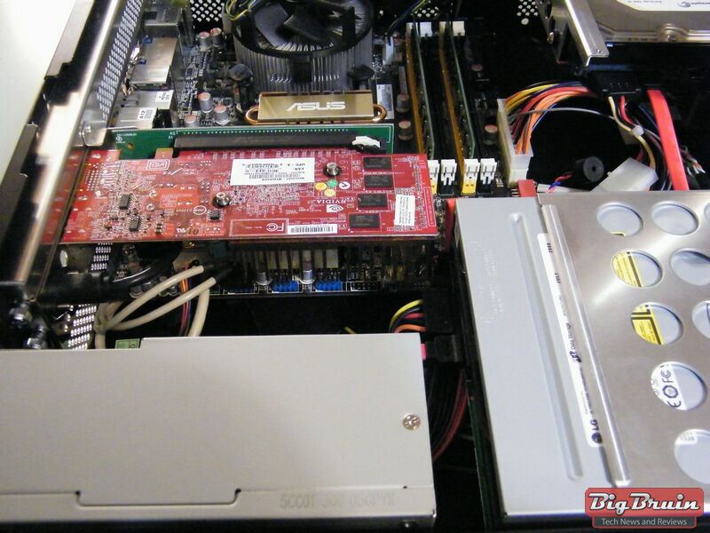

Hi, Could anyone give me the dimensions of the Pinnacle 7010ix card please? I'm thinking of buying one, probably on ebay, but I need to check whether they will fit in the Lian Li PC-c36B case I intend to buy. There isn't much room in the case. It will take a full height card using a supplied riser but I'm concerned about the amount of space where the card will fit. Here's a photo (from a Big Bruin review) showing a MSI GeForce 8500GT and it's very close to the DVD drive.
Thanks
http://www.bigbruin.com/2009/lianlipcc36/large/37.jpg
Mod Comment: image changed to a link, please do not hotlink to images from sites you do not have permission to do so from
