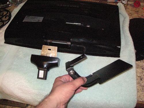

I need a swing arm mount for my Samsung T200hd 20" LCD TV/ monitor for space saving and flexibility. I use it primarily as a monitor. The problem is, the back of the monitor is slightly convex, not flat and I cant see any obvious fixings. The base has a vertical, thin plate that slots into the bottom of the monitor. I went on one site that recommended the usual 4 point bracket, but I cant see how they would work. The manual recommends only 1 'wall mount', the WMT 1900T, which I cant find anywhere. I have seen one that uses the vertical plate that slots into tv, but it's not an arm.
Has anyone got any advice or recommendations? Are there any universal brackets? or any good sites? cheers, any tips would be much appreciated.

I just got one and will use it as a TV but it has no wall mounts no Vesa no nothing the only thing I can think of is get a wall bracket and make a flat plate mount to fit into the base of the TV or smash - sorry remove the plastic stand from the fixing plate and weld or drill / screw it to a bracket
I think this will fit but its on US amazon and its the 2400T

ok , Ive done a little research and found some in the UK but its out of stock every where you could try emailing them
Product Code is TWMB1900
Technical Specifications
Basic SpecificationsManufacturer's Part NumberTWMB-1900Weight0.82kgProduct DescriptionSamsung TWMB-1900 - mounting kitDimensions (WxDxH)19.1 cm x 9.2 cm x 12.1 cmWeight0.82 kgProduct TypeMounting kit - wall-mountableMounting ComponentsTilt wall mountRecommended UseMonitorFlat Panel Mount Interface100 x 100 mmRecommended Display Size19" - 22"GeneralWidth19.1 cmDepth9.2 cmHeight12.1 cmWeight0.82 kgAV FurnitureTypeMounting kitMounting ComponentsTilt wall mountRecommended UseMonitorPlacing / MountingWall-mountableFlat Panel Mount Interface100 x 100 mmRecommended Display Size19" - 22"

Thanks for the tip, it looks like the only solution. I was hoping for something more flexible but it will have to do. I was actually considering your first post but thought better of it- had visions of my TV crashing to the floor due to dodgy workmanship . Cheers
